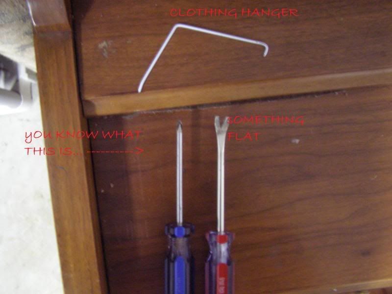

You can use a flat head in replace of what I used. As for the Clothes hanger, just cut it and make a handle then make a VERY small hook at the end. maybe 8th of an inch.

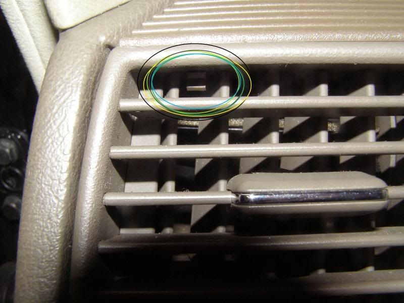

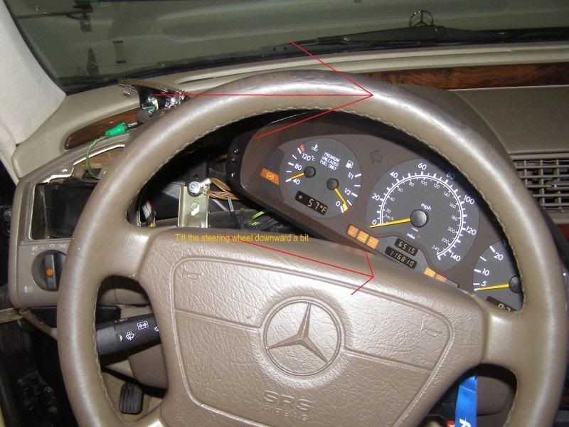

STEP 1

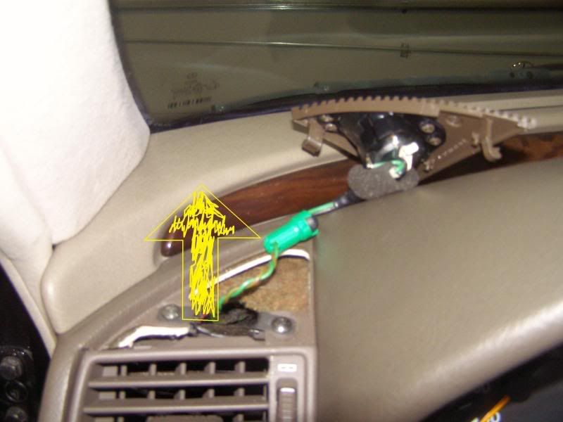

Look into your airvent and find the little tab and press it inward then lift up on the tweeter.

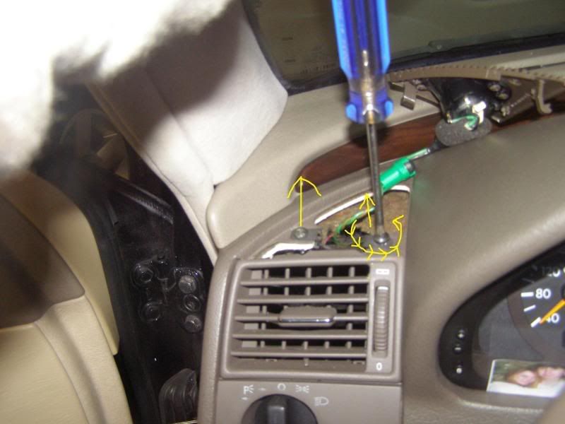

STEP 2

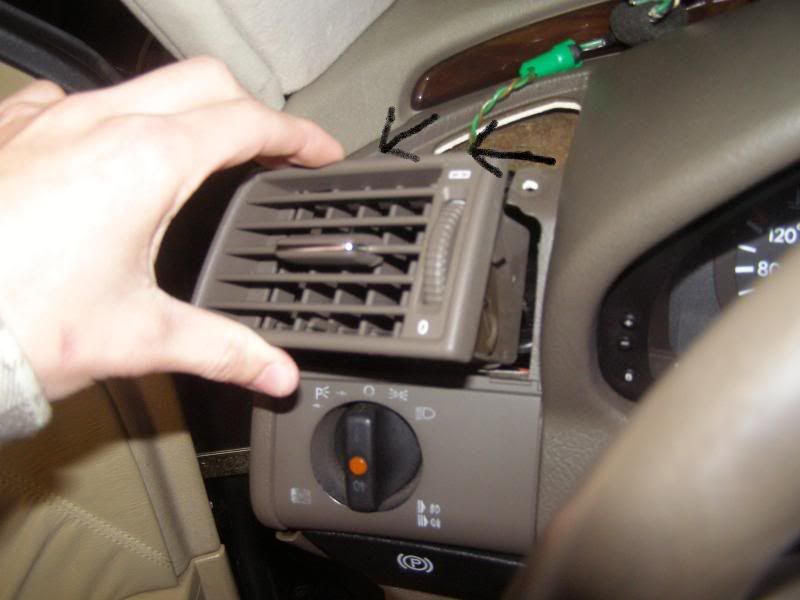

Now take out the 2 screws ontop (your airvent will be attached to these... Mine were broken just like everything else.), then remove the airvent just by pulling it out.
STEP 3

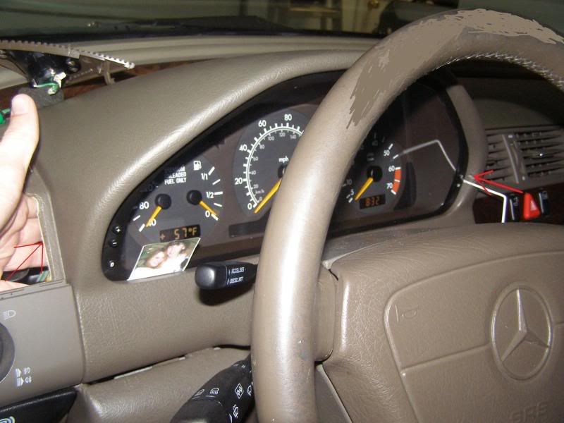

Now for the fun stuff (kidding)! Now go ahead and put your hook into the right side of your gauges by the minute and hour buttons about an inch deep then turn it to where the hook is facing the gauges then pull out until you feel it hook up to the slots inside. After uve done that, put your hand into where the Air vent was and reach back to the back of the gauges and push out while pulling on the hook... You shouldnt have to worry about breaking it... Push until it pops out.
Next you want to pull it out until it hits the steering wheel then push it to the right until all the wires get tight...

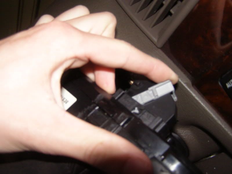

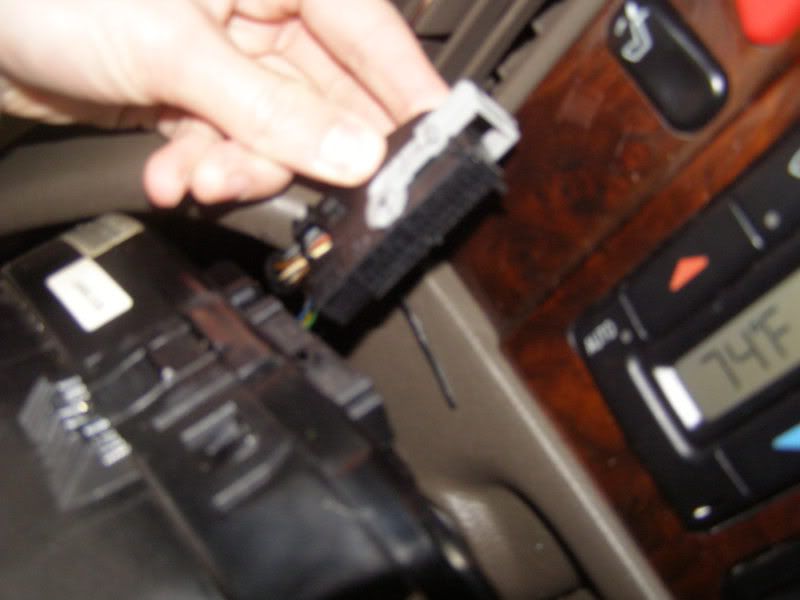

STEP 4

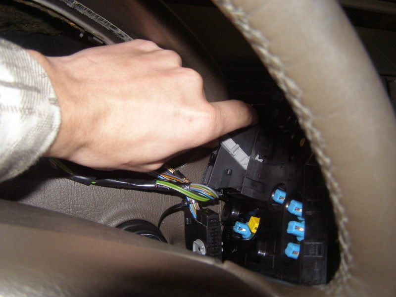

Ok for this, there is a tiny little button on the back of the plugs, in order for those latches to come back, you have to push the button down then slide the gray latches back and the plugs come out as soon as those go down...

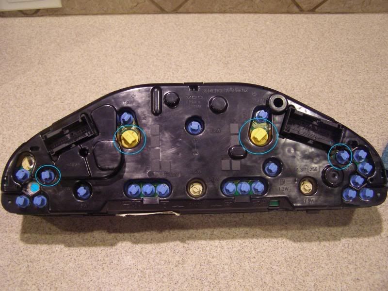

Other plug:

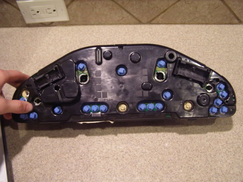

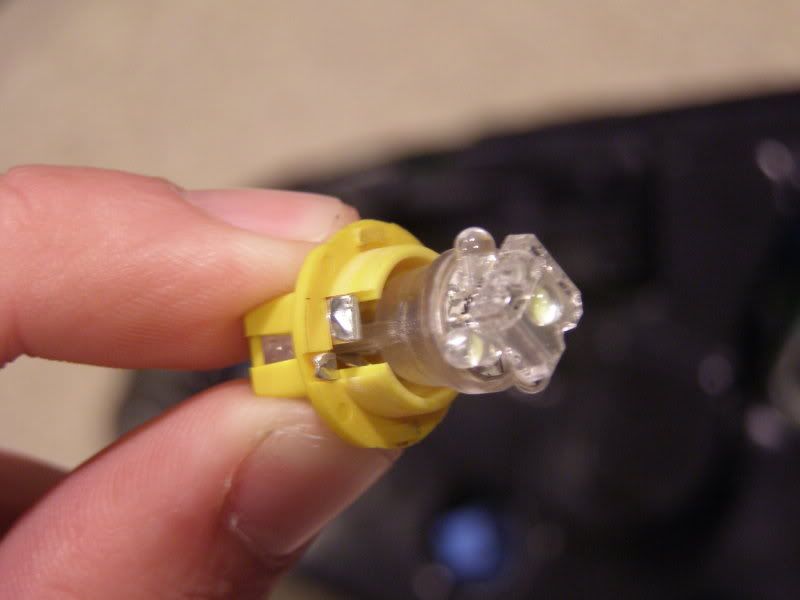

THE BULBS YOU MUST SWITCH:
Hope this helps you all out... to put it back in just go in reverse order.
What to order:
WLED-x5 LED Wide Angle LED bulb
FROM:
http://superbrightleds.com/cgi-bin/store/commerce.cgi?product=CAR
and
B8.5D-x Instrument LED bulb
FROM:
http://www.superbrightleds.com/cgi-.../cgi-bin/store/commerce.cgi?product=CAR&keywords=&cart_id=1149233.12628&next=50
STEP 1
STEP 2
STEP 3
STEP 4
Other plug:
What to order:
FROM:
and
FROM:
